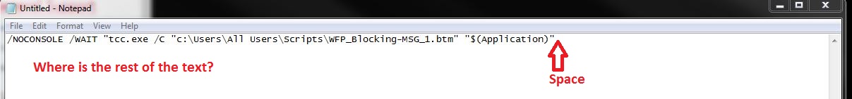

From /NOCONSOLE ... until $(ProcessID)" - which means the following ...
/NOCONSOLE /WAIT "tcc.exe /C "c:\Users\All Users\Scripts\WFP_Blocking-MSG_1.btm" "$(Application)" $(SourceAddress) $(DestAddress) $(Protocol) $(SourcePort) $(DestPort) $(ProcessID)"
... this selected text above is without linebreak (it's ONE line), it's wrapped only at V window border.
But then, after inserting the text looks like this:
(the last "sign" is a space). Of course, this is not correct! It copies until wrapping but not more ... Please see also these attachments ...

I found no solution to copy and paste this text correctly - also not with different preferences or LOF-options - except without wrapping, then it's no problem!
Is this a bug?
