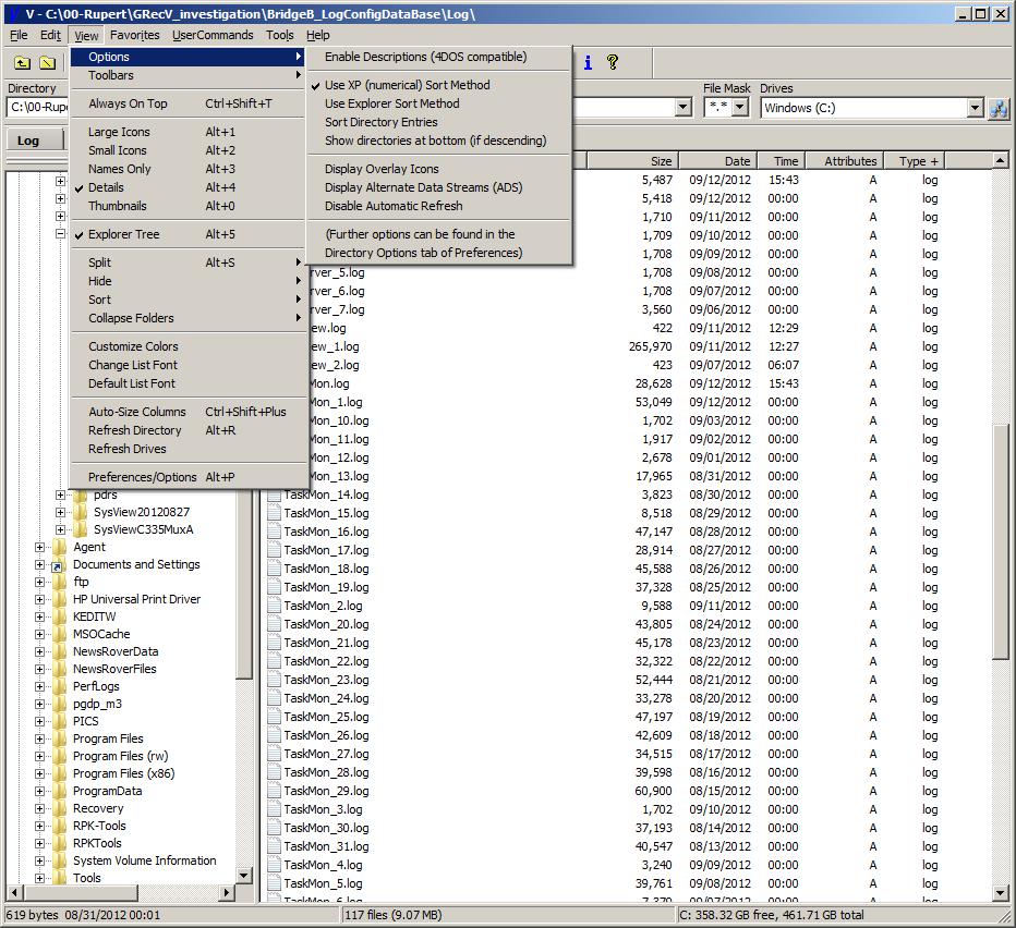

I think I thanked a bit too soon... It appears that the XP Numerical Sort option doesn't work correctly/reliably. At least not under Win 7 x64. I'm attaching a screen cap showing that the option is checked, but files aren't sorted correctly. I think the feature only works if the file name is the PRIMARY sort key, but is not used when the file name is a secondary sort key as my example shows. The XP Numerical sort should be used on file names any time that they are used as a sort key, primary, secondary or whatever.
V screen capture showing XP Numerical Sort failing when file name is secondary key.
